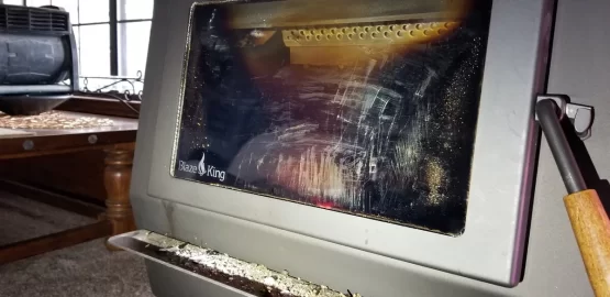

Maybe I haven't learned how to use the stove properly which is highly likely. Questions:
- Cat thermometer: I don't like to run it too high and anytime the cat thermometer runs off the hot end of the gauge, I turn the stove down. This usually happens if I'm not running the carpet blower off to the side (see next question). What is too hot on the cat thermometer? When I was learning this stove, I accidentally let it run to the 6 o'clock position, well off the high end of the active range.
- Blower option: the blower did not come in with the stove so I have been using a carpet blower about 4 feet off to the side to push air off the stove. This seems to help keep the cat thermometer running around 12 o'clock. I also read in another thread the BK blower option is under-powered. Is this really the case? Am I better off running my own blower (wife really hates it). The blower on our Regency was awesome, it would fill the whole living room with heat quick.
- Glass: I cannot keep the glass clean no matter what I do. And cleaning it is a major PITA. For some reason the soot gets stuck to this glass and a razor blade is a lot of work to get it off, forget using glass top stove cleaner like I did with the Regency. I used to hit the glass with that polish/cleaner and the glass would come clean immediately. Not sure what the trick is on this stove other than never clean it again and pretend its an all-metal stove. I may be running it too low as I want to make sure the damn thing is still hot enough by morning that I haven't been running the cat in inactive range.
The wood I'm using is live oak that I split two summers ago and is consistently testing at ~15% moisture content.
I'm all ears, open to suggestions. I really want to know if I should pursue getting the blower option added. We really hate having to use a stupid carpet blower sitting on the wife's living room table.
This is what I get to look at :( The scrapes are an attempt to get the glass cleared with a blade scraper.

It's appears that you are not running that thing hot enough at all. Either because your wood is wet or because you are afraid of turning it up. If you need more heat, turn it up. Don't worry about the cat meter other than to be sure that it is above the active line. I should mention that you should verify that your door gasket is snug which is just normal maintenance but since you'll be cranking it up you want this thing to work as designed.
The carpet blower isn't doing much for you since this model is heavily shielded on the sides. The BK blowers move air between the layers of steel against the actual firebox and will help but this is minor compared to you turning up the thermostat. You're stuck in second gear.
Your home is huge. Even 2100 SF with double tall ceilings is like 4200 SF of regular house. All of those fans could make it feel cold too. If need be, you can run the central furnace to supplement. Not everybody can heat 100% with a single woodstove. If that king can't do it when running hot then only a couple of others might do slightly better.
Once you get the stove to run hot, the glass will self clean. Even running on low settings like I do, only the bottom corners get that bark accumulation. The middle and top stay clear which tells me that you are majorly hobbling that stove.

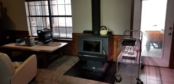

Is your stove burning on top of 2x4 lumber and bare wood subfloor? Glass looks clean.
It is...I unhooked the stove and tore out the old hearth and i am having a custom hearth installed starting tomorrow...

The low heat output AND black window suggests that not enough heat is produced. Either because byou are not running it hot enough or because your wood is wet (leading to a stove that is not hot enough). It's quite easy to have a clean window, and not having that is directly related to not having enough heat.

@SterlingSL , ignore the cat probe once you have the combustor engaged, try running that thing at full throttle until your wife is, umm, sweating and dressed in items that can't be described meticulously here.
1. As long as your fuel is above 12% MC (you are measuring correctly) you aren't going to hurt anything on the stove running wide open throttle. Imagine it is 1969 and you got a new Guard's Red GTO convertible and a Big Mac. Throw that styrofoam container out of the car and mash the throttle with everything you got. Nail that throttle to the floor and go find a beverage to savor while your wife is disrobing.
2. If your wife is still wearing layers when your fuel is burnt down to coals, I suggest you go looking on your exterior walls for air leaks. Windows, doors, receptacles, and switches. Maybe along the baseboard too.
3. On the BK website right now the King will do 47,800 BTUs/hour sustained at full throttle. An Ashford 30.2 can produce 35,900 BTUs/ hour sustained. In 1200sqft with good air sealing I can keep my wife in summer outfits at -50, -55dF outdoor ambient, with our Ashford chewing through cordwood like some kind of hyperactive termite. At 24 freaking above in 4200 sqft, with my A30 and 15% fuel I could have my wife naked as a jaybird in something like 12-14 minutes.
4. Black glass and 15%MC fuel tells me you are NOT running the stove very hard at all. A new combustor is going to be 'hyperactive' for something like 1-2 cords. Have you burnt two cords yet? Three words. Wide Open Throttle. Wherever the top of your swoosh mark is, the highest numbered paint mark, load the stove up, turn the knob to there, and leave it there for a week or two. You aren't going to hurt the stove. Enjoy your beverage.
5. Put the carpet blower away. When the fan kit comes in, install it. In the meantime you could try a regular 20 inch boxfan on the floor at the end of the farthest hallway gently (on low setting) wafting cool air along the floor from the distant bedrooms towards the stove.
6. Your glass is not clean because you are running the stove at such low settings, qv. I keep my glass clean by turning the throttle setting up to wide open in January, and December, and February, and November....
