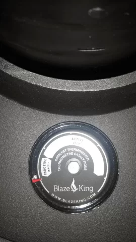

My cat probe actually points a fair bit below INACTIVE when the stove is cold. About a quarter inch below in fact.
When your stove is cold, the needle should point directly at the little tick on the dial at about the 7 o'clock position. If it is higher than that while cold, you should adjust it so you're not closing the bypass too early if you're going solely by the cat thermometer to know when to close the bypass.
When cold the needle is supposed to point at or near the bottom of the inactive range. If his is way below the bottom then he will actually be engaging the cat later than required which is not a big deal. The manual does have a section about this though.
The tick I mentioned is at the bottom of the inactive range.
I attached a picture of what my gauge looks like cold. It's an ashford 30 but I would think they would be the same.
Cool, that's how I set mine when I've adjusted it. This is an important guage.
