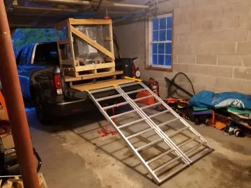

P.S. any ideas how to get this 500lb stove out of my bed safely with a ramp and no one around to help? It's not a completely smooth and flush slope (hinges, etc)

You can probably lighten the stove considerably by removing the cast iron cladding, firebrick, ash pan, door, etc. Not sure of the Ashford but many cast clad stoves are easily disassembled. Might make for a much easier offload. Good luck, enjoy that stove, a beauty
You can shed some weight by removing the top, Ashpan assembly and the sides.
I’d keep it wrapped up and slide it down the ramps. Then unpackage it. We use furniture sliders all the time, they work great once you get it close to its destination.
I would rent an engine hoist. If you can’t do this call friends... if friends can’t help and your all alone... I would devise a pulley system around your garage.
Or if your 6’5 and a beast you could just muscle it down.... the problem is slowing it down as it slides out
Would it remove enough weight? Maybe half would be manageable. I'm worried about it getting stuck getting down the ramp and my truck being really out of commission. I also would need to unwrap it.
Thanks guys.
This is one of those jobs where you remove the tailgate. Then put your ramps right up to the truck bed.
I use ramps made of 2x10 lumber and the pallets always slide down in a controllable manner. Never stuck and never slides on its own.
Don’t worry about the weight, you’ll never lift the whole thing. Scoot, slide, pivot, into place.
Reactions: webby3650
I removed all the cast iron and the ash draw etc, reduced the weight considerably, wheeled it right in the house myself,
was not too difficult. I think I would cover your ramps with some plywood to make a smooth surface.
Good luck
[Hearth.com] BK Recommended Flue Length[Hearth.com] BK Recommended Flue Length
That isn't too much of the problem. The ridgeline tailgate rotates out and I could put the ramps up to the bed. But the Stove Pallet is up about 3" ontop of the hearth pad and another pallet. Right now it is too heavy to scoot by hand. I can use some HD ratchet straps to slowly scoot it but I can't move it once I get close to the door.
That’s a really steep angle but doable I would tailgate like high beam said then strap stove down pallet then jack up front end of truck block tires. This will change the angle for a better control or chain fall from rafters but most important is eliminate snags
Good luck
View attachment 233665View attachment 233666
Oh but that was the AF20? It's a little lighter to start. So if I line the ramp with boards and remove all the panels I might have a chance getting it down into the garage. So would you guess 1/3 or 1/2 the weight?
Get a buddy to help you then slide on your steel toe boots
If you strip the cast and brick out, that might be 100 pounds, you're still left with a 400 pound stove. Less chance of damaging the cast if you remove it.
2-3 people will have that stove slid down that ramp faster than you can post here. We slid our 600# stove down a homemade ramp from the truck. It took longer to assemble the ramp then it took to slide it down.
The Ashford 20 is about 50 lb less than the 30, I estimate removing all the cast and bricks is closer to 150-200lb less
Not too bad to move with the hand truck.
I just moved my Woodstock in by myself with a hand truck. I usually bring the lift escalera lift home from work which makes it way easier. I wasn’t too bad though.

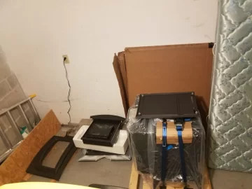

Hey guys, thanks for all the suggestions and confidence! After removing all the panels, bricks and pan I could slide it around. I bought a second board and 800lb dolly. I threw a mattress at the end and slipped a 5' cant hook through the pallet for extra tipping safety. Let it drop and it slid down nicely!
I also backed up to our steep driveway which took off 15° of slope. I then used the dolly to slide it into the garage. Took most of the afternoon.
