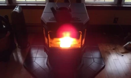

I've switched to Somerset pellets, and the stove is running wonderfully. However, even with Somersets, I still get a thick band of opaque build-up on the top 4" of the glass after about 12 hours of running. It starts with a haze after as soon as 15 minutes, then slowly builds up to thick and black. This band has appeared with all 4 brands of pellets I've tried so far. Someone had mentioned that if this was happening with all brands of pellets, then there is a problem with my stove. I have no problem getting the glass clean. The shop vac with brush attachment takes 99% of it off. I use stove glass cleaner only when a wet paper towel can't get the last bit. The manual mentions that the glass needs to be cleaned every day. Could it be that this is just the way it is with this stove? If not, what can I try? [Hearth.com] Black glass

I adjusted the combustion blower setting. It looks like I may have been at 4 of 5. Now I'm at 5 of 5. It's hard to tell what level I was actually at as all the settings on the stove share one meter that only switches from displaying heat setting when you adjust them. I'll clean the glass today and report back tomorrow. Thanks for all the tips. My auger feed rate is trimmed to 2 of 5. Perhaps I can try slowing that down one more notch as well if the added air doesn't do the trick.
I have the exact same on my NPI40. I can reduce the buildup on the glass by increasing the air to 5 (so it takes 2-3 days to build up, not less than a day), but my fire gets really small and "blowtorchy" and I don't seem to get as much heat.
typical of a "rich" burn, fuel air balance is skewed toward the fuel. literally all of the advice above is worth trying. what we have is either a leak , door window ash drawer etc burn pot maybe not seated squarely allowing air to get past it instead of through it, high EVL is a possiblity dont know thge hookup you are using so we might come back to that.
do "dollar bill" test for door and ash drawer if possible , if not use smoke or a match flame tracing around each gasket with stove running to see if we are sucking air (do this before it lights as the glass is known to get pretty dang hot) if the stove is equipped with an "airwash" system, check the air supply for it for blockage or restriction.

i'm going to try inspecting the exhaust system today and looking for leaks as well. today is much warmer than yesterday, so i can afford the down time. the instructional video mentions that i should discard the exhaust blower gasket and replace it whenever I inspect it (at least that's how i'm understanding this). obviously, i don't have a new gasket handy. do i need to worry about this?
skip to 7:51. (i couldn't figure out how to link to the time in the embed)
yesterday i gave the stove a full "end of season" cleaning. i didn't find any terrifying blockages, but there was a fair bit of buildup in the exhaust system. unfortunately the glass still blacked up in under 24 hours. i think it's burning a little hotter, and the buildup is less than before. any increase in efficiency is good, i suppose. since my stove is fairly new, i've called in my installers to have a look to check for leaks or anything i might have missed. they'll be here some time after the holidays. to be continued. merry christmas, pellet friends.
