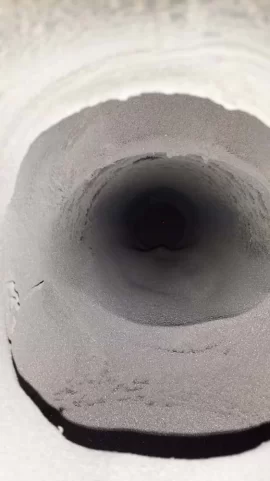

Cleaned my flue today..about the 15-20 bag mark...
