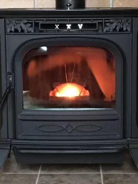

Here is picture of soot on my XXV after about 2 bags of pellets.

My glass looks about the same, but never had the black soot before until after cleaned it. I check for obstructions in OAK and Stove Pipe. Both good. Even ran brush thru.
