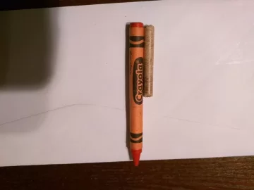

Alright so an update to my last post regarding these pellets. Again the smell is great when you open a bag and when they are burning. Nice light pellet, and a surprisingly small bit of ash. the one issue I am having is the darn pellets are too long. I've increased the burn rate to the maximum but because the pellets are too long, the auger cannot feed them at a substantial enough rate for a good burn. I need to jack up the feed rate on my stove and run it at a #3 heat setting just to keep a somewhat consistent fire in the box. I wrote the company about three days ago and haven't heard back. As soon as I do I'll post their reply. I'm not sure I'll buy these until the pellets are of a shorter consistency

Hmm....I've burned alot of different kinds of pellets and never had issues like this. I'm pretty good at trouble shooting things, and this to me seems like a length issue.

I got a ton of these Ironstone mills pellets I'm burning and they are the longest I ever seen. The Ravelli chews them right up though.[Hearth.com] Blackstone hardwood pellets
