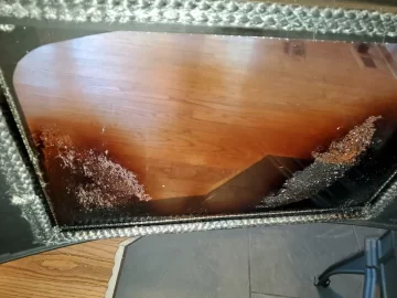

Hello everyone. First time posting on here and new to burning in wood stoves so bear with me on some of these. Looking for insights from other Blaze King owners. I had my Blaze King Ashford 30.2 installed in June of this year and have burned in it about 4 or 5 times since then.
My current setup has 6 inch black double wall stove pipe coming out of the stove 2 feet, then 2, 45 degree elbows transitioning into about a 2 foot horizontal run through the wall, into a tee, then going straight up about 13 or 14 feet. All pipe after it goes through the wall is Class A stainless insulated chimney pipe. Most of the vertical pipe runs inside of a chase on the outside of the house. I will include pictures for reference.
All my wood is at max, 21% moisture content. Mostly white ash. No softwoods.
All the burns I have done were during mild weather. Upper 50s during the day, low 40s/upper 30s at night.

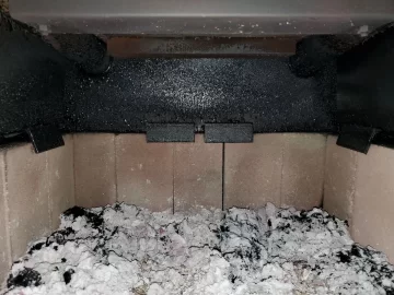

My first question has to do with creosote on the glass and inside of the stove. I am seeing pretty heavy deposits of black, tar looking creosote on the walls and glass. Its also very difficult to remove from the glass. Almost like a baked on enamel. Granted this is after burning on low/medium for about 12 hours. Even so, running the stove on high for an hour doesn't seem to do much in the way of removing it. Is this something normal with these stoves since they run so low? Is this a low draft problem?
My next question would be smoke coming from the chimney while the catalyst is active. While running on low/medium, I noticed white smoke coming from the chimney cap. This was not immediately after reloading but about 6 or 7 hours later. Whenever I reload, I make sure to let the wood burn on high for at least a half hour before turning the thermostat down. Is this normal or is this a sign that the stove is running too low and I need to turn the thermostat up?
I suspect both of these problems may have something to do with my chimney. Inadequate draft?
Thanks in advance for your help.

21% is high as far as Im concerned. If your running low and slow like the outside temperatures dictate you are that why the glass is getting sooted up. I'm north of you and I burn sawdust blocks this time of year. your wood moisture content might be ok in the dead of winter but not in October. Crank it up until the wood is good and chared or
get drier wood
by the way I have the same chimney set up as you and I have good draft
same set up

I think your chimney is borderline or not tall enough (despite examples where it does work). They recommend 15'. And for each 45 and each ft of horizontal run, one ought to add length to that 15'. Check the manual, they have explicit recommendations for flue length w/ elbows and horizontal runs.
That said, yes, running low does put tarry creosote in the box and on the window. Running a few hours high (as in fully open) should take care of that. If not, I think your draft is (indeed) insufficient. I think at 21% running high should get hot enough to burn off the creosote from the window.
Second, white smoke that comes out when running low but not when running high may be just water (same as breathing out in winter). When you run high, flue temps are higher, and it comes out as vapor (invisible). Running lower, it may precipitate out into visible "steam". It is hard to distinguish smoke from water vapor, but my experience (...) is that if it completely dissolves in a couple of feet, it is likely steam. Smoke is bluer, and does not dissolve, but dilutes. It still exists farther away from your flue.
In the end, you seeing creosote in the box is not surprising at 21%, running low, and (possibly) with borderline draft.
I'm inclined to think I'm short on flue as well. Will probably end up adding 8 to 10 feet. In regards to running the stove on high for a few hours to burn off the creosote, how do I keep the stove from getting too hot, as in the thermometer probe for the catalyst going all the way to the end of its range? I'd have to think that can't be good for the stove, correct?

The stove won't easily run too hot; that's what the Tstat is for. "All the way open" on the Tstat is not a setting where the bimetal coil won't close the air inlet a bit when it gets too hot. If you keep the door closed, overfiring is very, VERY unlikely with this stove.
Regarding the cat temp gauge: a new cat often is "hyper active", i.e. runs very high. Burn for a week or 2 every day, and it'll settle down.

I don't think I would add any chimney height until spring. Looks pretty normal overall to me, though mine is a 30.0.
Every once in a while I scrape the cresosote flakes off the inside of the box and give them a second chance to fly through the cat by letting them fall to the floor of the stove and lighting the stove back up; some folks scrape it out and take it to the dump. I pretty well stopped trying to clean the glass after about two seasons.
Two components to wood stove exhaust as someone above already mentioned. Cord wood is mostly a hydrocarbon just like oil. Long chains of carbon atoms with hydrogens stuck on everywhere they can go. Burn that, combine it with oxygen, burn it completely you should get CO2 and H2O. There are some minerals in there, a tree is a little more complex than that, but there is quite a bit of steam in your exhaust plume created by combining hydrogen with oxygen up around 600 degrees F. When it cools off, it will be white.
I am pretty sure BKVP has said a couple times here 22% is the absolute top end wettest wood that will work, but it also seems to me folks who can get a good quantity of fuel at 18% like it better than 20%. Don't be throwing kiln dried construction lumber in there trying to cocktail your total load MC down to 18%. 2x lumber just burns too fast. You don't want anything in the firebox under 13% MC or so, KD lumber is gonna be 6-8%.
If your stove is running pretty OK through the depth of winter I would leave the stack height alone and come back with fuel a little bit drier next year. You might try adding one (one only) of the bio-logs to an other wise full load of 21%. Like an enourmous wood pellet for pellet stoves, but the size of a salami. Try cocktailing your total load MC down with one of those if you want too.

BK princess owner here and I can tell you its a night and day difference from 20% moisture content to 16% moisture content with my stove, hang tight and wait for more cold for improved draft before doing anything.

Things will likely improve as outside temperatures drop. The height may be less of an issue than the long horizontal run. Long horizontal runs really slow down flue gases. I am wondering if this could be reduced enough to have the top elbow go right into the thimble. Is the stove at the minimum clearance from combustibles at the rear? This is measured from the studs or sheetrock behind the stone veneer and not from the face of the stone.
Also, make sure the tee cap is on snug and sealing well.

Yes, I agree, but the practical side of me looks at that stack and sees other potential issues. Colder weather should improve function hopefully. If not, then bracing an extended chimney will be paramount.

The white steam, buildup in firebox are both indicative of too low an operating burn rate given the MC/draft variables.
