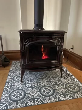

Our old little Jotul is now in the greenhouse. It sees a ton of humidity. The enamel is still fine.
I just stumbled on the thread from when the Jotul was moved to the greenhouse. The post shows the enamel off pretty well. Not bad for a 30+ yr. old stove.
That stove is beautiful. Thank you for sharing this.

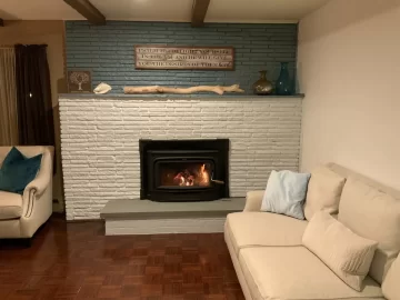

dafattkidd
Dec 11, 2007
1,852
Long Island
Thanks for all your input on this. I went with the paint finish and I’m glad I did. After four months of waiting it finally came last week. It was a little scuffed up from the delivery crate. Thankfully the installer/supplier had Stove Bright on the truck and touched it up (the exact reason I went with paint finish). Anyway, I’m so thankful this puppy is up and running.
