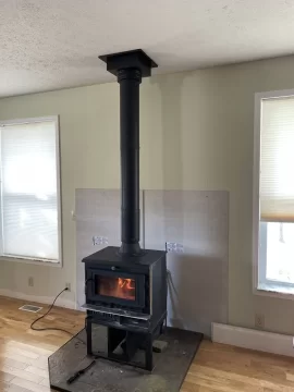

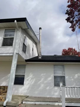

New to the the site have enjoyed reading everyone’s posts. I have ordered a Blaze King king 40 model. Is it acceptable to have 8” double wall from top of stove to celling ~65” then reduced to triple wall 6”for another ~14f?. This is my current set up with a older Appalachian stove. If left this was what would it hurt if anything ? Attached pictures of current set up. Thanks for everyone help.

8" all the way is the manufacturer recommendation due to the 4.35cu ft fire box, in order to run the stove correctly you need to get the wood load to run on high setting so it all can catch (plus run on high weekly to keep the creosote that develops inside the firebox in-check) 6" flue pipe doesn't allow the air volume to allow the stove to run the way it was designed to run, especially in a warmer climate like 30's, 40's and 50's.
Yes, in Kentucky you'll likely run low quite a lot. But that needs a real good run on high before you dial down. And for that you need the flow of an 8" pipe.
The good thing is that the OD of that 6" triple wall should be the same as 8" doublewall insulated, which I'd think would be much preferred, on a cat stove especially.

It appears your installation is straight up and out. While others pointed out need for 8" system for performance reasons (and they are correct), spillage will be a concern on 6".
Each time you open the door to load or reload, you want to avoid smoke spilling back into the room. Smoke in your home isn't diluted as it is outdoors. It becomes a health hazard..
