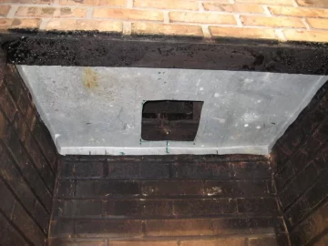

That kit you posted is only 9" x 24", so it would only cover your damper door opening, assuming your opening isn't bigger than 24". Most people like to seal off their entire fireplace opening in the top of the firebox of the fireplace. As others have stated, it's not too hard to fabricate a custom block off plate from sheet metal if you are somewhat handy with tools. When I did mine I made a template first out of some cardboard and used that to rough out the sheet metal version. It took a bit of tweaking, but in the end it came out with a very tight fit. To get a good tight fit around my SS flexible liner I first cut an 8" hole in the block off plate to give me a bit of wiggle room in positioning my liner to fit my stove placement just right. Here is what things looked like at that stage:
[Hearth.com] Block off plate?

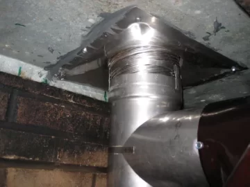

To seal this opening after I dropped my liner down through the hole I used a 12" square chimney cap plate and this gave a nice snug fit around the flex liner. I connected the cap plate to my block off plate with four sheet metal screws:
To finish off a tight seal I filled any gaps with stove cement. What you can't see in these photos is that I also laid some insulation on top of the stop off plate before I ran the flex liner down through the hole. So far it has worked great.
