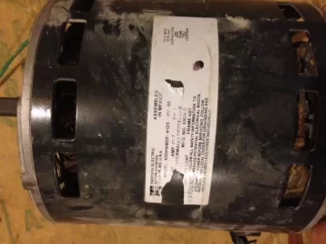

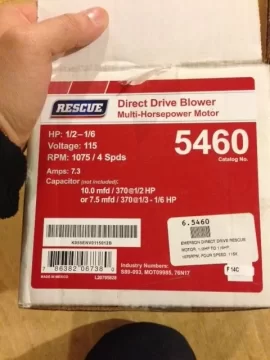

Technician indicated the direct drive motor was showing signs of failing - the unit is about 8 years old. He went ahead and replaced the unit. It's definitely a lot quieter but upon further inspection I see the OEM unit is slightly larger than the replacement - should I be concerned that it's undersized ?
Orginal specs show .85 HP / 10.7 AMP
New specs show 1/2 to 1/6 / 7.3 AMP [Hearth.com] Blower Motor [Hearth.com] Blower Motor
I'm thinking a good way to know would be to get a cheap $20 clamp-on ammeter from Harbor Freight (for instance), or just borrow one, and see what the motor is actually drawing. If it's comfortably below the 7.3 ampere rating you're good to go. Just be careful if you go with a cheapo meter, they're generally pretty accurate but they can't stand up to much in the way of rough service.
He screwed you, Have him come back and put the correct one in. Those rescue motors don't have the best track record either. They are perfect when you need a motor now, But at this time of year you had time to wait for a proper motor.
