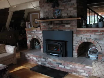

Hi,
I've had a Regency i2400 since March and I am debating whether or not to get a blower for it. I have been happy without one because the heat that would get blown out into the room heats up the brick fireplace (see pic below) which radiates heat into the rest of the house. I wondered if safety was an issue. In other words can too much heat end up in the brick and chimney or am I worrying about nothing?
Thanks for your help
  • [Hearth.com] Blower on an insert?
A blower will increase the amount of heat in the room, but I doubt there's a safety issue (assuming the hearth and chimney are close to code). That's a lot of mass. And thta's a plate stove, so you'd really have to work at it to overfire it enough to cause a problem. Not saying it's impossible, but challenging. Some other inserts (mine, for instance) more or less need to blower to keep from getting too hot.
I'd get the blower, then you have the option.

Oh, by the way, That is a really nice looking fireplace!!!!!!!!!!!!!!!!!!!!!!!!!!!!!!!!!!1
Thanks for the comments. It has been fun using the insert because until then, the hearth was never used and it's such a dominant feature in the house.
That is one great hearth, stove and picture. Two questions:
1. Is that poker so that you can tend the fire from across the room? That sucker is HUGE!
2. What lives in the birdhouse? Woodpeckers?
My wife and I moved into the house about a year and a half ago, it was the same house she grew up in, and the poker and huge axe (the blade is just visible at the top of the picture) were both on the hearth when I met her parents...that made me a bit uneasy that's for sure. Now to answer your questions:
1) Yes the poker is huge, I've only used it a few times, but I can sympathize with the person who was worried about breaking the glass on their stove door. I'm not sure if I can avoid it this heating season!
2) The bird house! Well before this house we lived in a very small condo, and had no room for such things, so my wife made displays and I guess the bird house was part of the display...I guess it would be more effective outside now!
