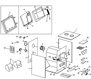

It seems a bit odd to me that you have more than one blower for a house that size, can you provide more detail on the blowers you're using? Are they squirrel cages?
I recall some of the hotblast models having dual blowers.

Yes mine has dual blowers. I believe 400 or 450 cfm blowers. What I’m wondering is if it’s safe to run it with these unplugged. The furnace is in my basement on concrete so I’m not worried about it contacting anything and burning it. It just seems that with the blowers going, I have to have dampeners wide open to produce much heat. I can open the duct work right above the stove, and it’s barely warm even right there. I know by the time it passes through all the duct work it cools lots more. I’m thinking if I run without them, maybe the radiant heat from the stove will create a hot air/ cold air exchange through the house and possibly be warmer than with the blowers forcing air through the house. Hope this makes sense. Thanks

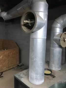

With your blowers running, the furnace may be cool to the touch. Your ductwork or plenum leading from there will be warm. Could you post a couple pics of your setup? Chimney type, size, height, etc? Also are you burning seasoned wood? With our old woodfurnace, around 350-400 on the surface of the furnace would produce alot of heat in the ducts.
Some pictures of your set up would help us help you.

You will notice the duct is open in the picture, the air is hardly even warm coming out of there honestly. The furnace heats well up until about 30 degrees, any colder, and it struggles badly. Another thing, the furnace is on one end of my house in the basement. I live in a 75’ double wide(roughly). The duct work coming out of the furnace runs the length of the house and just has vents for each room. I can understand why the far end of the house is cooler. But I don’t feel like it should be chilly. Every house I’ve ever been in with a wood stove, they are very warm and generally the dampners are turned down. My house is decent warm(except for on cold days) and I have to run my furnace so wide open that there isn’t even any smoke coming out of the chimney. I know that is a clean burn but it’s also a very fast burn lol and yes I am burning dry seasoned wood
