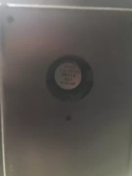

The sticker is what’s inside the black box on top left of the furnace. Thought maybe that the numbers were 120-130 degrees?

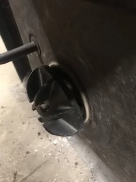

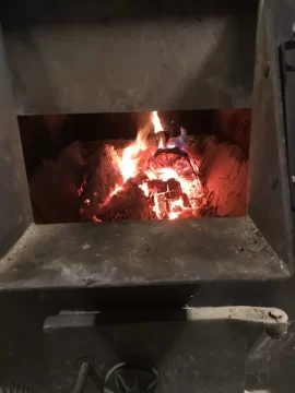

They are tied into my gas furnace ducts I believe. Only reason I leave the one duct open directly above the stove is because it blows directly at my steps, I leave the basement door open and it works as a giant register lol. The duct that is open runs to my spare bedrooms, and kitchen and since the living room and kitchen are open floor plan, and the basement door is right at the end of the kitchen, it seems to work better that way. As far as if I’m burning hot enough, I will include a picture of dampener position, and it is 10 degrees outside right now, so it’s open more than usual. At this position, the gas furnace has still kicked on approx 3 times in the last hour or so. I will also show a pic of my fire, last time wood was added was about 2.5 hrs ago. As you can see with the fire, it’s wanting more wood again, already. And the gas furnace is still kicking on occasionally... the propane bill is the main cause of all my frustration lol

Have you filled the firebox? That only looks like a few splits. I would fill mine to the baffle with wood.

Get a magnetic thermometer and put it above the loading door. Shoot for about 400 degrees or so and she should cook! Those furnaces are much more forgiving with sub seasoned wood that's for sure!
