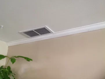

Has anyone ever try to set up there blower on the back of their stove with duct pipe to go into the ceiling through the floor upstairs to push hot air into the second-story room. Are there any risks about hot air blowing up or fire ambers going up there. Also will it work with approximately 10 feet to the end of the Vent to blow the hot Air into that room.
That would violate code for sure. A floor register with a fusible link damper is an approved alternative.

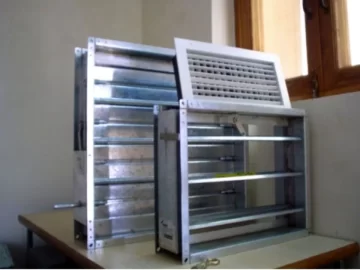

I put a vent grill in my ceiling it goes up through the floor to where the baseboard heat pipe goes up to the upstairs I have no duct just a vent. The upstairs floor has nothing the hot air just goes up through the hole where the hot water pipe for the baseboard heat goes thru. I just don't think I get enough heat upstairs that's why I thought about the vent with the blower. This is the vent that i have in my ceiling and is this the damper you think I should have.

It takes a decent sized register to convect a lot of air. I would go with a 12x14" grille and fire damper. The fire dampers you show are overkill. Here are some lower cost dampers and grilles.

Thank you for the suggestions but the upstairs room is closed off to my house. It is a dormer where my mother lives so i can only access it from the outside. I don't think I would want to have a huge hole like that in my ceiling it will sort of stand out. maybe I'll just leave it the way it is and hope it helps heating it in the dead of winter. But do you think if I have the blower on high blowing hot air up to the ceiling it will blow the air better through the vent. I just don't know if it's worth spending 250 dollars for a blower for my stove if it's not going to help to go through the vent for upstairs. I definitely don't need the blower for my house my house is a nice comfortable 78° With three splits.
Not a hole, there would be a between the joist grille and register upstairs. A large ceiling grille is common with built in AC systems.
