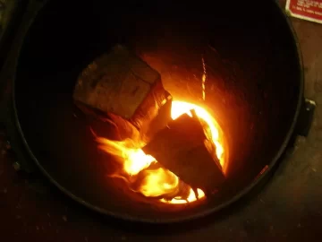

Fact. I often get some blue flame when things are very hot. usually second half of burn. here's a video
of mine spiting out some blue.
http://youtu.be/5Hq1WvFHTE4

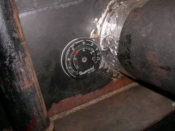

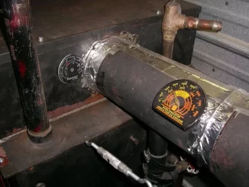

Dr Hill's Jetstream design still shows a very efficient operation. Pictured is the flue gas temperatures before and after the draft inducer port.
Low flue gas temps may be due to efficient operation through nearly complete heat transfer, but they can also be due to excessive air being introduced. If the temp in the secondary chamber is averaging 1800 F and the average flue gas temp is 350 F, that seems to indicate a fairly efficient boiler. It's not clear to me how your photo is confirming efficient operation of your Jetstream.

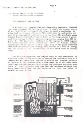

Have included a picture of the boiler's basic design.
Flame color varies with the stage of combustion and the eye of the particular human or camera making the recording. In the boilers we sell, often times the bluest flames come during the poorest combustion with wet wood. Most of the boilers discussed in these threads have E.U. data if not U.S. data. Ask for that information from your prospect suppliers. Don't get hung up on flame color.
