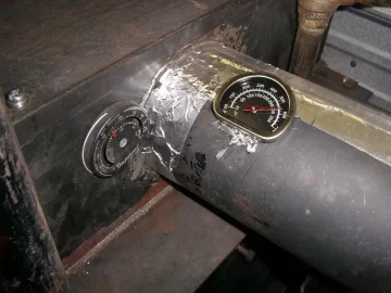

Dr Hill's Jetstream design still shows a very efficient operation. Pictured is the flue gas temperatures before and after the draft inducer port.
Low flue gas temps may be due to efficient operation through nearly complete heat transfer, but they can also be due to excessive air being introduced. If the temp in the secondary chamber is averaging 1800 F and the average flue gas temp is 350 F, that seems to indicate a fairly efficient boiler. It's not clear to me how your photo is confirming efficient operation of your Jetstream.
Pride goes before the fall. :bug: You really got me thinking on the external temp gauges and my assumption! So the only thing available was a BBQ gauge with a 2 1/2" probe. It installed pretty easily. The combustion air and draft inducer air is supplied by one blower. I ran one heating cycle of the storage tank at max full out air for the temps seen in the other pictures. Today, I reduced the air flow resulting in much higher flue temperatures on the magnetic gauge and internal gauge. But the surprising result for me was a 2 % rise in efficiency in heat going to the storage tank. There was snow on the roof today so I was unable to go up on the roof and do a sniff test. I am working on getting an old CO2 tester going!
Thanks again for the wake up!
