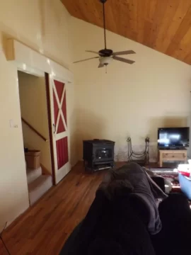

Hi All,
I'm about to install my T6 and I was told by a mason that it's accecptable to builld my 1 inch thick Blue stone ember protetion directly over my hardwood floor. He suggested " a vapor barrier with lath and a scratch coat". I'm aware that I will need to drill into my hardwood and thats okay by us.
Does this seem like good advice?
thanks
Neal

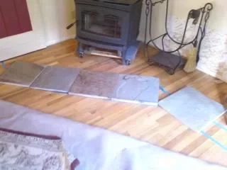

I spoke with a general contractor and there is no problen with the weight of the stone. The 800 lbs of stone will to be spread over 60 plus sq. ft. The harth is a fairly simple (flat) design one that will please my wife fit the room and provide the proper ember protection.
As I mentioned in a previouse post I'm a firefighter and I would never be able to walk into my station if I burn my house down. hahah

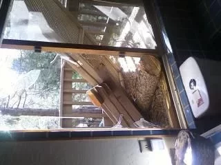

Here are two pictures one of the stones near my stove and the second is of a window I broke while trimming branches that will be close to my chimney. GREAT MOVE ugggg I think everyone will enjoy my mistake.

Oops! On the tree trimming. I'd llike to have that on video.

I would investigate if the ember protection of the squares of bluestone is to code. ie what if an ember falls between the cracks? I would guess this is a mute point if you are using grout between the individual pieces
Good point. If not grout, sand should be used.
