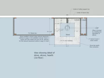

Yes on the OAK. I had another thread asking about it. I'm doing an alcove an BKs paperwork requires it. The manual I downloaded implies that the kit needs to go through the floor, but I'm going straight out the wall behind.
