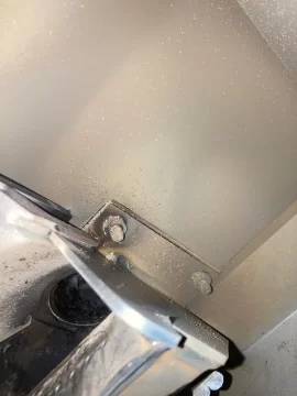

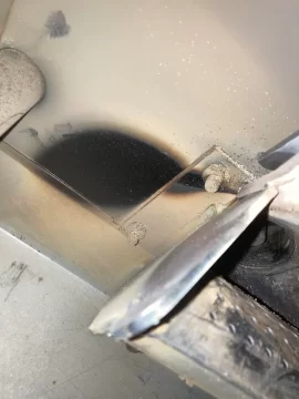

Ray,
Thanks for that insight. I went to vacuum out my stove and I noticed the left side of the burn box has an ooze streak of black, whereas the right side does not. attacking some photos to show you, but I’m not sure if this is normal or not and if it may be contributing to the smell at startup? Looks like a streak coming from the left side underneath.
stoveliker
Nov 17, 2019
7,261
Long Island NY
In a wood stove that would suggest an air leak there, which could expel some smoke.
Reactions: warren0127
johneh
Dec 19, 2009
4,919
Eastern Ontario
I would agree but that's inside the firebox which is under vacuum
when the combustion fan is running so it pulls air into the firebox not pushes air out
Reactions: stoveliker
warren0127
Mar 31, 2023
22
Maryland
Thanks. But regardless do you think this is still an issue with the stove itself? Perhaps the burn pot assembly needs to be replaced if it’s leaking?
