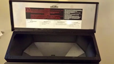

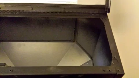

I'm confused about the pin on top of hopper. Is there just a hole there? If you are talking about the switch kind of thing that you flip up to open the hopper, that would be a problem. It has to be there. Can you take a picture of what it looks like?
Same here unless in 2014 they changed the design. But if that switch is not in place otherwise the stove won't run. My P61a has the switch and its a 2013. Lets ask another question, are there wires leading to the switch location ? They would be inside the hopper.
The schematic in the user manual does not show a hopper switch. Upon checking my XXV manual it too does not show a switch but there is one. hmmm...
I have a knob that you open hopper bin with with, and a latch, but the other stoves I saw had a silver pin that censored when the hopper was open, I don't have that. I thought that was a feature for most stoves now.
There is no wiring in the hopper.
Here is a picture.

It shouldn't be this complicated. Doesn't look like your hopper lid is missing anything. If all doors are closed, it could be a bad feed motor, or faulty pressure switch. I think you're going to have to wait for the dealer to take a look at it.
