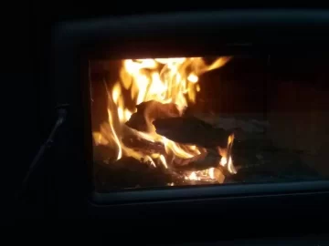

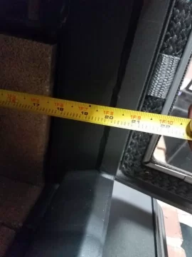

The manual says 20" max, 18" recommended size splits. However, if I do N/S @ 18", it seems like it would be off the firebricks (picture below). I'm about to cut and split a bunch of rounds and I'm not sure if I should measure 16" or 18" if I mostly do N/S loading.

I stick to 18" maximum for N/S, but have slipped in some longer ones burning E/W.
Reactions: BetterCallMaul
16" to 18" is best. Although the closer they are to the glass, the more they offgas against the glass and haze it up. 17" is optimal, as they fit inside and in front of the boost manifold. Cold starts are easier if the splits are propped up on the boost manifold some, as the air space below makes for good ignition to the bottom of the splits.

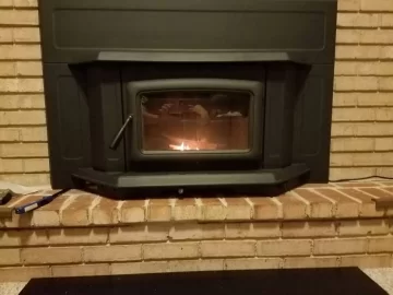

Just an heads up and alert:
--the stove front to edge of brick hearth dimension appears to be on the short side. With the raised hearth, embers etc will travel further than you think. Even with a ? fire resistant mat ? on top of berber carpet, I would caution all users of this stove to be on the alert for smoldering carpet while using the insert.
I think you'll find your stove like 16" logs, like Hogz said, you can go a little longer, but you'll fog your glass. +1 on your front clearance, be careful, coals love to roll, especially when pulling them forward.
