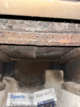

Here’s a picture of my warped baffle plates. You can see how their sagging in the middle where there overlap. It’s mainly the baffle plate without the overlap piece.

I don’t know if that would be a problem as far as safety. I could imagine if baffleswas warped enough to allow flames to hit liner, buildup of soot could catch fire. However, regular chimney sweeping should negate that.
How does stove run when using it?

The stove seems to work fine. I was concerned about the warped baffle, mainly it’s the one without the lip on it.
My other concern was the build up with the clogging the spark arrester screen which I think is probably being caused by the Duraflame log (1/3 of a log at a time). So I will have to use a different fuel. Which also I started maybe thinking that the wool product I used instead of the metal baffle plates might not provide enough heat to help burn the fuel adding to the spark arrester screen buildup?

The wool keeps the fire box hotter than a metal baffle plate alone, and that leads to more complete combustion and thus to less deposits.
That is the purpose of a baffle and insulation on top of it.

Just going back to the wool baffles. I tried to get the warped baffles back in but to difficult at age 76. So I ordered the Wool baffles material. I hopping by not using the Duraflame logs the spark arrestor won’t get clogged up so fast.
Also I was using 1/3 of a Duraflame log with a piece of pressure wood product.
