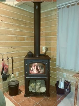

Figured I'd post a pic of my father in laws new quad. I believe it's a 3100 limited, it's got 3 soapstone tiles on each side. He just sent me this pic he lives in a small cabin in Fairbanks, ak. They've been having issues with poor air quality in town. Some sort of incentive if a new stove will cut your emmisions in half they give you money on a trade in. His old stove was one of the smaller hearthstones from early 2000's. I guess his decision came down to this and one of the 20 series blaze kings.
