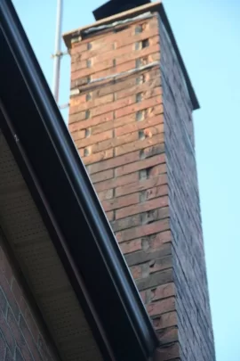

The brick on my chimney has started to deteriorate, especially on the south side. I received a few quotes and everyone agrees that the portion above the roof should be rebuilt, but I am getting differing opinions on what to do below the roof.
Some masons are recommending cutting out only the damaged (spalled or cracked) bricks and replacing them while others have recommended that I should tear down the whole chimney and rebuild it as it is only a matter of time before the other bricks incur similar damage.
Obviously rebuilding will cost more than replacing the individual bad bricks, but I don’t want to do a cheaper repair if it means I’m going to have to revisit it in the near future. I have researched here and online and still don’t feel I have a good grasp of how likely the remaining bricks are to deteriorate.
I attached a few photos. I’d like to get opinions from any experts or even people who have gone through this. I’d like to figure out the scope I want and then I’ll get the contractors that I’m most impressed on to requote on the same scope.

I see bricks with chips out of the surface, but maybe only 2 bricks below the roof that have cracks as opposed to cosmetic issues, and maybe 1 or 4 above the roof.
Why is anyone saying this should be rebuilt? (I believe you guys when you say there's a problem but I don't see it in the photos.)
What caused that interesting column of chipped bricks on the one side above the roof? Is that caused by the chimney leaning out over that corner?

Perhaps the photos don't do the full justice. Above the roof bricks on every other row are spalled on the south side and there are a few bricks on other sides that are also damaged. Below the roof there are probably 20-30 bricks that are either spalled or have cracks.
It has been suggested to me by everyone that this is water damage from water getting inside the bricks and then freeze/thaw cycles causing the bricks to crack/spall. I was told the south side is likely most damaged because any snow/ice can melt on sunny winter days and then refreeze at night.
I have been told that the damage I can see is the last stage of damage and many other bricks are likely in bad shape on the interior side. I'm no expert either, but I have heard this explanation by almost every mason I spoke with.

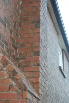

There are some exceptionally wide vertical mortar joints in that structure. It makes one doubt the skill of whomever constructed it; it wouldnt be surprising if there are other hidden problems. It also appears like the chimney is not original to the house, given how poorly the brick is toothed into the facade in the second photo.
Sometimes this type of spalling occurs when a hard portland cement mortar is used with a soft brick, such as when modern mortar is used on historic masonry. The grade of mortar should always be softer than the brick. Ask the mason about this if you choose limited repairs.
I'd considered how quickly it took to get this bad and what percent of damage is below roofline. If rate of deterioration relatively slow and confined to top, you might consider limited rebuild unless the aesthetics bother you and you have money to spare.

Thanks for the feedback. If the visible damage below the roof is limited to 20-30 bricks would you expect the remaining bricks to be in good condition if all water issues are resolved (new chimney cap, flashing properly sealed, etc)?
Chimney is original to the 30 year old house. The mortar used in the house has eroded on the angled part of the fireplace as well as on window sills. Based on this I don't know that it is necessarily hard, but I'll ask about this as it is sounds plausible.
The wide head joints are due to the brick size.
It seems more likely the widely varying joints are because the mason didn't want to cut any bricks.
Ideal head joint would be 3/8", with variations in brick size resulting in head joints anywhere from 1/4" to 5/8". The layout could've been planned with cut bricks for a better final appearance and consistent head joints. Some of those head joints look almost 2" wide.
To the OP...it's really hard to offer advice based on three photos. However, 30 year old bricks shouldn't spall like that unless there was something wrong with the brick/mortar/installation or there's been no maintenance to the crown/top. At worst, after 30 years you'd expect maybe to need spot repointing of some mortar joints. Certainly having a proper crown with good drip edge to keep water from running down the brick face will help longevity. The photo is very blurry, but it doesn't seem like outer edge of the crown/cap has a drip cut. With surface tension, water is tenacious and will run right out over and back to the wall face below without a drip cut.
It seems the house wall protected by the roof eave isn't experiencing the same spalling, so I'm not sure the brick itself is entirely to blame.

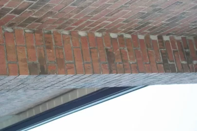

In the 3rd picture, the capping bricks on the sloped masonry aren't ideal...it'd be better with the bricks installed as sailor course (wide face to the weather, with long direction pointing downhill) or a steeper pitch if the bricks are to be coursed like that. The current arrangement has lots of horizontal joints to collect water that needs to run off quickly, rather than collect in the joints.
It's hard to tell from the pics, but it doesn't seem like the mortar joint tooling is the problem. You want a concave or a weather-struck joint. Raked joints or anything like that will just allow water to collect and lead to problems.

PS. Brick window sills are a terrible construction detail for the reason you note....the mortar joints deteriorate relatively quickly and let water into the structure. Get those fixed too.
The brick used on this chimney are thin, that is to say the two heads and a normal joint don't equal a stretcher.
Sometimes when you notice a Very tight joint between stretchers and large joints on the opposite course, the Mason is kinda screwed by the material.
He can't cut the stretchers because he would have to cut all the opposite brick thin. The wrong size brick for a 16" pier. Having to wrap the flue with those brick are a problem.
