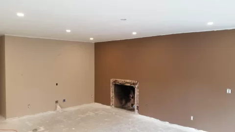

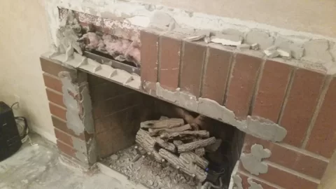

I'm working on remodeling my family room, and my plan is to have a gas insert (FireplaceX 616) installed into my existing fireplace. During demo, I removed the existing raised hearth and face brick around the fireplace. (The first picture was taken mid-demo.) The floor is concrete slab, and I've installed tile over the slab. My plan was to replace the drywall above and beside the fireplace with cement backer board, and then install a stacked stone tile from floor to ceiling, extending about 12" on either side of the fireplace.
The installer for the gas insert told me that I needed to replace the face brick before he can install the insert. I'm trying to understand what the building code actually requires. If I install cement backer board and 1" thick stone tile, does that meet requirements? Or do I truly need to have the 4" thick brick, extending 8" around the fireplace, to meet code?
