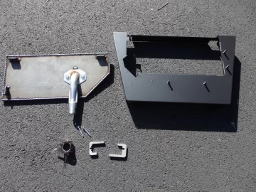

The original burner is no longer available but this is the new replacement burner kit from Jotul. The original burner was cast iron and steel while the new one is all steel. It comes with a new burner, burner skirt, air shutter and spacers to raise the pilot assembly.
I don't think there was anything wrong with the old burner but we use propane and I've been fighting with delayed ignition since day one. This was kind of a Hail Mary just to see if it will make a difference. Unfortunately it took so long to get, it will probably be next winter before we can give it a good test.

I've discovered a small interference problem with the new burner replacement kit. I wanted to open the air shutter a bit more but it wouldn't move more open even though there was still a lot of travel in in the slot under the fender washer. I took everything apart and was able to open the shutter to where it had been with the old burner but then the burner skirt wouldn't sit in place properly.
It turns out that one of the brass colored studs on the air shutter is too long. If you install the skirt first and then try to open the shutter, the stud will hit an edge of the skirt. If you open the shutter to full travel, then a lip of the skirt sits on top of the stud. I cut about 3/16" off the stud on the right side and now have clearance to open the shutter with the burner skirt in the proper position.
I was curious if you happened to notice this on the one you installed?
I wanted to follow up on my post from last year.
After using our stove now for the past several months I can honestly say that the delayed ignition problem has been eliminated. We did not experience one instance of delayed ignition where with the old burner it would happen dozens of times during our heating season. In spite of the premium price for this kit we now consider it money well spent.
