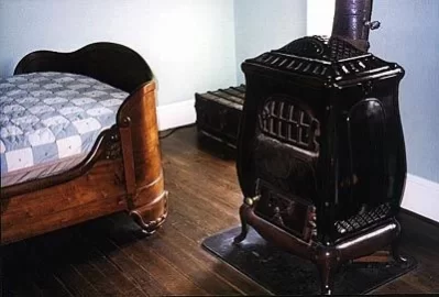

My husband inhereited a Bridge-Beach & Co Wood Burning Stove that we will be installing in our home this summer. We have been looking for some information on this stove, but we can't find anything. We need to get the glass repalced in the door and a few other things need fixed as well.
Any suggestions?
I just found something that may help.
Our stove is just like this one, except it is baby blue.
The caption on this picture states that it is a "circa 1920s Bombe' Superior Circulator Parlor Stove, manufactured by Bridge-Beach & Co., of St. Louis. The stove exterior is wood-grained enamel over iron with pierced domed top grid and serpentine legs. "

I see. First you need to assess what needs to be done to it, if anything. As a coal stove, it most likely has a firepot made of some sort of refractory material in the base. Some coal stoves did not, esp. cast iron ones; but most did.
If you are going to burn wood, then it most likely won't need a refractory assy.
If you do a search on google for Antique Wood Stove, you will find several good companies that deal in these type appliances.
If the stove is in good shape both internally and externally, then you may be able to burn it as is. From what I can see there is mica in the "windows", you can get this from a few of the dealers in Antique stoves. If you wanted to do a complete rebuild, it could be as simple as taking it apart and cleaning everything, then putting it back together with stove cement (you can also use very thin stove gasket with the cement in some cases. If there are any cracks in the castings you can have them repaired but it is unlikely that you are going to be able to do much with the enamel finish in those areas.
Having said all that, you need to know that this type of wood/coal stove will put out significantly more emissions than a modern stove. And, you should observe the general clearances for non UL approved appliances, when you install it.
Whatever chimey you install it to, for safety and ease of maintenance, you should line it with a good stainless steel chimney liner product that is the same diameter as the stove: which looks like 6 inches.
