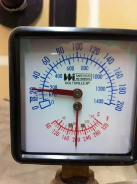

My question is I have got it up to 180 and notice my pressure is higher than last season. When I started 1000 gal storage was 50 f and I have 80 gallons expansion just thinking when water was that cold all summer my auto fill might have let in more gallons to heating system if it dropped under 12lbs
Does anyone know if I have roughly 1050 gallons total and want to operate at 120 f min to 200 f max how many gallons I should remove to stay away from 30psi pop offs going pop?

I just bled roughly three gallons off manually with pressure relief valve that was dripping a bit and it dropped to above picture

Hard to tell what's wrong without a guage on your expansion tanks. Can you check them with a tire guage? One of your bladders could have sprung a leak. If you've got 20psi at 200f like your guage is showing (is that your boiler or storage?), you should see quite a big pressure drop when things cool off to even say 170f if you've lost expansion space to being waterlogged. You really should isolate your expansion tanks & drain all the water out of them then pre-charge with air to whatever your system psi would want to be at the temp it's at when you do that. Say if cold 10, if hot 20? But it might be hard to tell if you've got water behind your bladder from a leak by draining the water out the bottom - unless you leave the drain open for a while. If you have a valve to check air pressure with & water comes out of that, you've definitely got trouble.
Tire gauge is reading same as boiler and no water came out I thought I read on here several places 5% expansion I put in 8% to be safe
