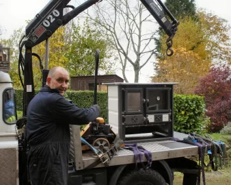

Hello
Well heres a picture of the Rosa been delivered!
Fantastic service from the delivery man he is situated in the north of England and carries mostly heavy machinery.
You can find him on ebay and because his vehicle is small he can drop things through your door!
We slid the cooker across the tiled kitchen floor on a bit of old carpet a lot easier than I thought.
So will report back when installed!
John

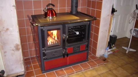

Hello Folks!
At last the Broseley / Nordica is finally up and running it works beutifully and the oven easily maintains 200c.
If anyone requires further information let me know.
Best Wishes John

It looks great. My wife wants one, even though we have nowhere to put it.
Sounds like I'll have to make somewhere........ ;-)
That has to be a nice addition to the house. Thanks for the update. It really fits in nicely there and looks beautiful. How does it cook?

Hello Again.
Thank you for your comments.
As I said the stove works very well appears economical yet very hot!
Have not had time to try serious cooking yet. But tonights frozen chips were done to a crisp!
The cooking temp seems remarkable stable. I have only been running a small fire yet the oven seems to maintain 200c with no difficulty.
Regarding the origin of the product I think this model comes from Italy as all the cast parts have a N for Nordica cast in them.
Although it is a bit of a mystery, the Serbian model has many small differences The door castings have a different format. the hinges are not the same the casting at the front of the firebox has a different no of "teeth". The guard rail brackets are also not the same. The internal damper for the oven is cast on the Nordica and sheet steel on the Serbian version. The removeable panel in the base of the oven is not as robust.
So all in all not the same even though it looks very, very. similar perhaps a copy just that bit different not to infrnge patents etc. Can anybody in the stove industry tell us the truth?
Oh incidentally lighting is a dream just the same as the youtube film on the Serbian Magnum 30 to 45 Mins and your cooking on gas, So to speak!
Best Wishes from the Yorkshire Dales England
John
Good info John. I would love to cook in and on that stove. I'm not sure about the Sopka. Maybe they are using some Nordica castings and assembling their own version in Serbia?
Looks great, love the way they delivered your stove, great idea!
