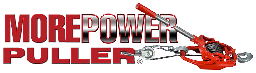

I have a More Power Puller rated for 3,000 lbs. single line pull. How much do you see this tree weighing? Give it one cut in the middle to reduce the weigh in half.
[Hearth.com] Bucking oak out of a swamp....
The winch supposedly will pull 6,000 lbs. double line but I don't exactly know how to do double-line?

whahoo,,,run the cable to the tree,,thru a pulley and back to the winch. That is double line,,,just like the pic you show. If you took the hook to the tree, and did not use the pulley,,it would be a single line.

Yes there are ropes that can handle 5k lbs...the hoist pictured shows a load rating of 6600 lbs doubled.....doubt you could pull the handle...

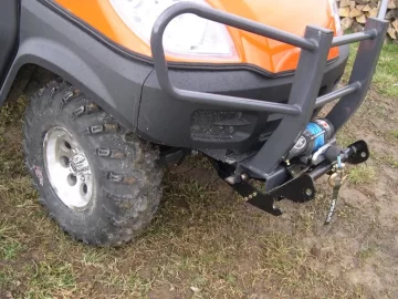

for sure,,, my kubota uses rope on the 5K winch mounted on the front of it.

One reason these specialty ropes are replacing cable on winches,,is they are safer. I can stand right beside my rope winch and guide it as I pull heavy weight,,something I would not dare to do with a cable winch, or chain on a dozer. The cable or the chain can cut you in half. I have snapped chains with my dozer and found them 75 feet away. We all know what cables do when they break!
Note: i still use chains but have no more cable winches
