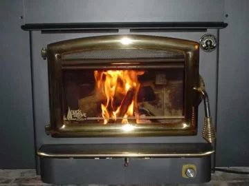

I also have a Buck model 51 with the optional blower. My stove is setup as a fireplace insert. I try to keep it at 450/550*. This seems to be the best temp for my heating needs. The stove design is not the best for using a magnetic thermometer because of the double walls. I put mine on the upper right corner on the front. It will read ablut 100* less than a reading taken with the IR thermometer pointed at the glass. At 450/550 the stove is no where near over fire. With 25' of 6" SS straight up, I had to block off some of the secondary air inlet, otherwise the stove would try to burn like a blast furnace.
