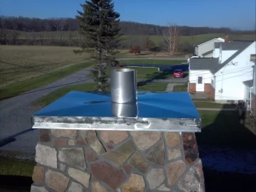

Here is my cap, it only cost $45 dollars! ;lol
It's 6'x3'.
It's 6'x3'.
