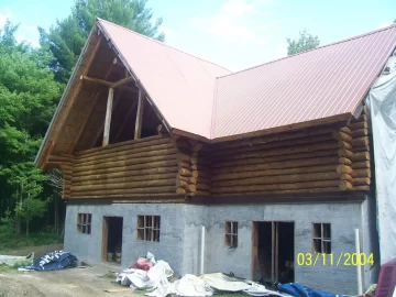

We started to build a small cabin , as we [Hearth.com] Building a New Cabin, Need Some Advice moved a long , it grew from about 1000sq ft to 2100sq ft. Radiant heat throughout , walk out basement family room and shop. We will have 2 woodstoves and an antique wood fired cookstove for our main heat, with the propane fired radiant floor as a back up. The basement woodstove has a stainless coil to heat water for the basement radiant floor to take the chill out of the concrete.
