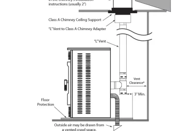

3" pellet pipe to an approved 6" class A chimney in good shape is approved by your stove's manufacturer. This is the argument I'd use with local building officials.

3" to 6" is usually doable but it depends on what is written in your install sheet that came with the stove and also Local Codes..Is it safe ? Probably. Passing is another thing. If your install sheets don't show that configuration you're probably out of luck. But the install guys should know this stuff.
The manual does show that configuration so I would question the inspector, if its a code issue then I would go back on the installer.

The installer should have submitted a drawing with the clearances and an example of the install. I would present a copy from the manual that shows the 3" to 6" adapter. Be nice as possible and approach him in a manner as to explain that the MFG instructions show the install.
Also have the installer call him to review the MFG instructions. Lean on the installer a little, had he submitted a drawing all this could have been avoided.

Like the poster above shows, the manufacturer approves adapting it into a Class A, pretty much like mine in the basement is, so it should be a moot point.
But asking the inspector for the stuff to show the vendor should do the trick. The inspector has probably never seen a pellet stove and is going on the wood stove thing that pipe needs to match flue collar size.
