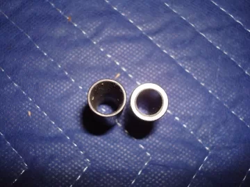

The wrist pin is probably the most obviously different part in the kit. However it fit quite nicely in the piston's bore with the bearing (also included)

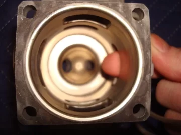

Ah yes, the cylinder! Casting quality looks superb although the intake port looks to be off kilter a bit from the OEM jug on the right. The exhaust port is noticeably smaller too.​
[Hearth.com] Building the MS460: Epilogue - The 2nd Saw [Hearth.com] Building the MS460: Epilogue - The 2nd Saw​
The left shot is my index finger in the exhaust port as far as it will go using the old OEM cylinder. The right pic shows the same "test" with the new aftermarket cylinder. Just looking at it, the transfer ports appeared to be a bit smaller on the aftermarket cylinder as well.​

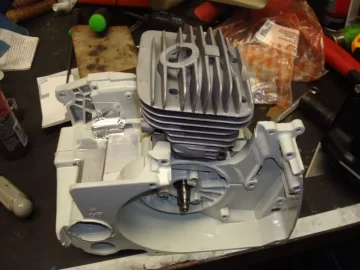

And there's the long-block assembled. The saw is a bit further along than that now. I will take some more pics once I get it buttoned up but this ain't gonna be a detailed build thread like the original Building The MS460 thread was. Short and sweet to find out if these cheap aftermarket parts are worth buying/using or not.
One thing I noticed is that the crank seals are very tight compared to the OEM parts. You can feel them drag on the shaft as you turn the engine over. Time will tell if they break in or self destruct!
