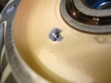

    My options are as follows:
    1.) To hell with it, part it out, wash my hands of it and forget it ever happened. I have a fair amount of $$ into the saw as is and am reluctant to spend more. However, I will not come close to recovering all of my investment with this option.
    2.) Buy another rough looking but complete and undamaged crankcase and repaint it like I did this one. Roughly $125 + shipping. Painting it will never be nearly as durable as the OEM powder coat but just might be enough of a facelift to make it presentable. Still going to make for an expensive saw.
    3.) Go all in, new crankcase for $200 + shipping, sell off as many parts as I can to lessen the sting. <> Saw will look and run fabulous and I'll be quite happy with it other than the $$ invested. ;hm
    4.) Or there is option #4, tear it down again, JB Weld the puncture, (the damage is not in a sensitive area or structural) and rebuild. This will relegate the saw to my personal collection and no farther.
    No matter what I do, there is no longer any profit to be made with this saw, so that renders the keep it or sell it argument moot.
    Gonna think on this one for now, but I'll make a decision here in the next 12-24 hrs. Y'all will find out what I decided in short order. ;)

    Can't weld it? I wouldn't even think of spending $200 on a case unless it was the ONLY way to fix it.
  4. MasterMech
    MasterMech
    Guest 2.
    Could weld it, although I've never done Magnesium before, should be similar to Aluminum. Realistically, the JB will likely be just as good and far less risky.

    I would personally JB it up since it is a puncture and not a stress crack (easier to repair an much better chance on not expanding in the future). My old Suzuki dirtbike had dual plugs...the previous owner stripped one and I ended up JB welding it. If it can repair a cylinder head without issue for 5 years I think it will be fine for a crankcase.
  9. Jags
    Jags
    Moderate Moderator 2.
    Staff Member
    Aug 2, 2006
    17,616
    6,180
    Northern IL
    This would be an easy TIG weld job for somebody in the know. Get it fixed for a few bucks and continue down your original path. Once you JB weld it - you own it.

    Grind off the powder coating at the repair area and get-R-done. If you know peeps with TIGS, you probably already know somebody that can weld it up for you. I ain't against JB Weld, but I ain't for it either. Sticking two things together is one thing, using it as a patch is another.
    And down the road, if your heart ever changes, you will have no "sellers" remorse over a hokey patch. Your name will be attached to THAT saw.
  16. kd460
    kd460
    Feeling the Heat 2.
    Feb 5, 2006
    400
    4
    Yep, tig it and be done with it. I would have no problem buying a saw with that type of a repair, with JB, I would have a problem buying that saw...
  17. MasterMech
    MasterMech
    Guest 2.
    A patched saw is my saw. Maybe a giveaway (or dirt cheap) but with full disclosure on what was done.
    Problem with the TIG weld approach is the powercoat on the backside of the weld area. I'm worried it will contaminate the weld and it's not accessible to grind off.

    You won't have to blast much. Only the edges where it might contaminate the weld. 1/4" around the hole should be way more than enough.
    Oh - and when welding, make sure you are at a place that you can jettison the case outside. You are welding magnesium.>>

  25. MasterMech
    MasterMech
    Guest 2.
    Ok, not exactly carnage pics, but here are a few shots of the damage.
    The culprit.
    You can see there is only about 1/16" of material making up the crankcase wall.
    Plan is in place to continue building the saw. Stay tuned!
    smokinj, Nixon and DexterDay like this.
