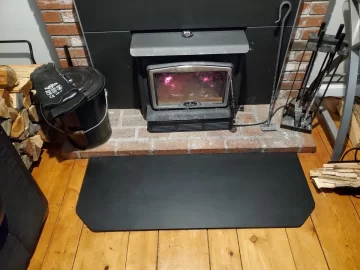

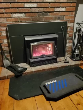

I cant answer all of your questions but I have an Osburn 1600 and it's my primary heat in our two-story 1600 sq ft cape in Central MA with a 24' external wall chimney. Fairly similar to your set up. It has a 1.85 cu ft box which is relatively small but it is a work horse...my back up heat only comes on if its less than 5 degrees overnight. I wouldn't call it fancy like an enameled Jotul but it looks sharp and as you said in your post, SBI has good customer service, easily findable parts, and the Osburn line are quality stoves. It's very easy to use and clean.
The 1600 is the pre-2020 version so you'd be looking at the 1700. I can't say how the 170p burns as they made some changes to get from 4 gm/hr to sub 2 gm/hr but I'd say it's likely still fine, especially on a 25' chimney.
The brushed nickel trim is optional, it also comes in all black. Mine protrudes about 8" onto the hearth which I like as it helps get more heat into the room, especially in a power outage.
