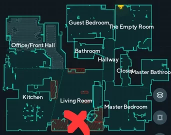

My home is a single story ranch about 1800sqft. My floor plan (provided by my robot vacuum) is attached and the red x is the stove location. Our primary heat is propane. I don't think we'd plan on having the stove be the primary heat source.

Also, in terms of house layout, how well might the stove heat the master bedroom? The living room has a ceiling fan and i can also run the HVAC fan any time to circulate air but I don't know if those will distribute air well enough. Doesn't really change my plans for the project but I'd like to manage expectations. If I go any larger with the stove I'd have to use NFPA 211 rules to reduce clearances. Right now both of these stoves should not require any heat shielding.

Where are your cold air returns and where is the furnace located? That could really help circulate the air.

Furnace is in the garage. There is a cold air return on the opposite wall of the living room, about 25ft away, and another in the kitchen about 15ft from the stove location. One in each bedroom as well.
I'm not sure where the garage is, next to the kitchen? If the Kitchen and Living room are open concept that will help. If you heat with wood you could always add some electric heaters to top up the heat in certain area's. Then have the furnace set to come on when the fire dies out. You could get some good air movement which is good so you don't get the LR too hot.
Yes, next to the kitchen.

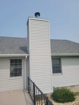

Roughly how tall is the chimney on the current fireplace? Many modern stoves require 16' of flue to draft well. The exceptions are several Canadian made stoves which breathe a bit easier and can work well on a shorter flue.

RE: heating. The bedrooms are going to get the short end of the stick. Heat doesn't convect well via hallways and normal room doors. The Master BR could be served by the common wall having a fan in the wall using the stud cavity as a duct with the intake high on the LR side and the output low on the MBr side. This could be thermostatically controlled. In many cases the most effective results are when colder Br air is blown toward the stove room, letting convection pull in warm air from the stove room through the hallway and door.
FWIW, using the hvac blower can have mixed results. Most ducting systems are quite lossy due to leakage and uninsulated sections. The heat loss has been considered acceptable when the temp coming off of the furnace is 145º and a duct loss of 20º is not uncommon. But in the case of moving hot air from the wood stove, the air temp may just be 80º and a 20º loss through an long, poorly insulated return kills any benefit. If all the ductwork (supplies and returns) are sealed and well-insulated, and in the conditioned home space, then using the furnace blower may help.
The chimney chase is 19ft floor to ceiling including the flue extension above the chase, so it should have about 16ft of flue.
The entire flue and chase cover will be replaced by the installer as part of the remodel so I suppose we could make it longer, but I'm hoping we can make the flue straight with no bends which the manual states will only require 15ft, as we are below 1kft elevation. I also am considering an outside air kit. Our house is not super tightly sealed but it just seems like there are no down-sides to adding one after looking deep into the forums here.

19' is perfect. No need for taller. The lack of local service could be an issue for any stove, if there are warranty or service issues. The more complex the stove is, the more this may be an important factor, especially if the stove is used a lot for 24/7 heating. BK stoves are well made and parts support is good. Their design is one of the best for cat stoves. Catalysts last typically about 10-12,000 hours. That's about ~3 yrs for 24/7 burners. Factory support for BK stoves is good, so is their forum support here. The BK community is strong and supportive.
