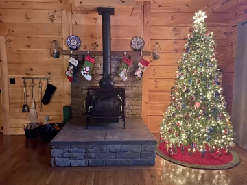

This is what we did with ours. No alcove.
  • [Hearth.com] Free standing stove for in fireplace?
Maybe I can talk her into this. Seems simplest. As someone mentioned, no there is no fireplace yet. This will be in the second story of a garage addition. Garage downstairs, living upstairs with a stove. It’s all for looks. Building a full out stove as someone else mentioned with fire brick and so Forth is great but I think it would fall through the floor in my situation haha
I run a very similar arrangement with my Jotul 602 except that the stove makes a 90 degree transition into the flu before the mantel. My mantel is brick, and about eye level; and the stove is placed outboard the mantel protrusion.
I believe you could achieve the same configuration with double wall stove pipe and a wood mantel and be well within clearances.
