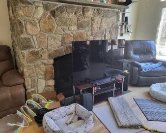

Post some detailed pics of your current fireplace setup. This will help with recommendations.
As I understand it, we are upgrading to heat pumps and solar, and already have a generator for short power outages. Hub is in charge of house mechanicals, like the furnace and well and so on, which includes the heating plans. I am in charge of the garden and bird feeders, trail cams and pool (never had a pool of my own, so a big learning curve!)
The main room is very open, with big windows, so not a lot of options for where the tv goes. The plan is to mount the tv above the fireplace, and we'd really only use the fireplace in case of multi-day power outages or zombie apocalypse.
We did have a gas fireplace in Colorado, and I would turn it on for the cats, but we never used it for house heating... I have always thought they were inefficient for actual heating.
Pictures below:

Love the stone fireplace- a nice wood insert will look right at home there. So looks like a gas log set is in fireplace now, so you'll need that removed. Ideally, the gas line should be removed as well, as most installers will not put an insert in a fireplace with gas line there. As minimum, the line should be pulled down from below (hopefully unfin basement) and hole filled in up in fireplace. X everyone else, get dry seasoned firewood going now, so less frustration later. I agree too, if its a pleasant experience in burning wood, most people will want to do it more than they originally thought. You can save some money on heating, you're paying yourself for your efforts (cutting, splitting, stacking, bringing it in and burning... Get a couple of install estimates, some installers are better than others, or will give you more things to think about and choose from. If this is a summer project too, you may get a better deal doing it when its out of season. Good luck, stay warm.
Reactions: LoraxGirl
