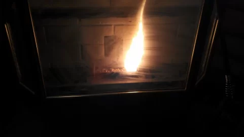

Just finished adding the gasket and it fired up. It will be interesting after a couple of hour to look how much ash I have in my burn pot.
  • [Hearth.com] Burn pot full of ash in my 55-TRPEP
I want to thank all of you for your expert advice, I think it has paid off. I went through a 40 rd bag of pellets in 19 hrs and things are working very well. No need to dump ash out of the pot this morning, No black soot on my glass and only about a 1/3 of the pot with ash(between the 2 big holes). I will give a good cleaning fill it back up and try it again.
1 last question. Do you think I can live with the gaskets on the cradle, do I need to modify the burn pot to sit flat, or do I need to order a new cradle (Kind a pricey solution)
Thanks again, its great having the stove work as it should.
