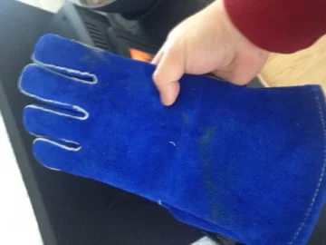

Hey all quick one here. I know the vid for pot scraping shows turning down the temp to 50 degrees to scrape. Why not just turn down the temp dial ( blower) down to scrape?
Have the gloves...flame isn't to intense?

If my p61 is really in high ramp up I just wait till it tames down a little bit. Can be too intense for bare hands yes .. A high burn can be rather scorching especially for a quick scrape of the heat exchanger ! I just did this yesterday with gloves on in fact. I did not turn the stove down, it was in a low moderate burn at the time.. I wore gloves fwiw, but just regular work gloves. No problem.

[Hearth.com] Burn pot scraping? I slowly open the door and scrape wearing these
Yeah I just turn the blower down and scrape, close the door and turn it back up.

Unless the flame is really cooking, I don't bother turning down blower or temp. I may turn temp down a little (not to 50 though) just to get the stove to settle down a bit, but usually just open the door slowly then scrape. I haven't used my welding gloves since last winter when I was really paranoid that I would burn my hand.
I already burned the top of my fingers hence the welders gloves. I might be wrong but watching the Harman videos, the non insert Harman stoves seem to have more clearance in the burn area in general.

If clearances are different, that would certainly be something to think about. I also spent many years working with really hot stuff, so my fingers are probably a bit tougher than the average persons. That being said, I still wouldn't stick my hand in there until the flame died down after opening the door.
