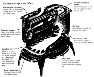

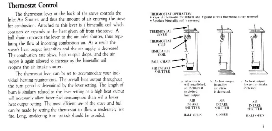

BeGreen said:
..... The original VC stoves came with a thermometer and guidance on how to use it. They need to get back to better user docs.....
I keep on looking for that elusive thermostat on my VC Defiant. BeGreen, where did they put that little bugger? :question: :coolgrin:
Sorry, the thermometer wasn't built-in. My original VC Resolute came with a magnetic Sand Hill thermometer to put on the stove top. I sold the stove long ago, but still have that thermometer.
The thermostat should be a bi-metallic coil connected to a secondary flapper intake on the back left side.
