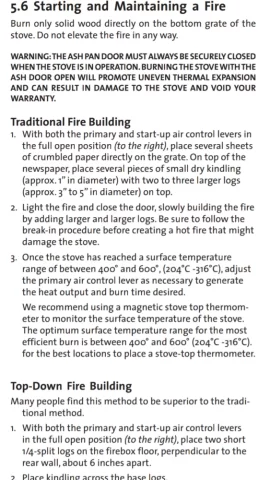

**I am Assuming you are talking about a Jotul F3CB**
From the manual, link below, you wait until the stove surface tempurature reaches 400 to 600 degrees (F) then start adjusting the air for the desired temperature and burn time, which, I am sure will vary. Maintaining a fuel quality will help you get consistent results. They recommend 6 to 14 months drying time and a moisture range of 12 to 20%. The manufacture has a specific break in period with recommended temps.
(broken link removed to https://jotul.com/us/products/wood-stoves/jotul-f-3-cb#technical-area)
