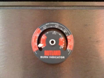

Yep, get a thermometer like this one or other brands. If Rutland, this particular model from them is made in the USA! Some are not. And it has excellent accuracy for what it is, as I regularly check it against a laboratory thermometer.
I also have an old Vermont Castings stove-top thermometer which has similar accuracy. Also search the forums on this very fine Hearth.com for lots of info on thermometers and their use.
Choose wisely, return it for exchange if it is not accurate and use it carefully.
