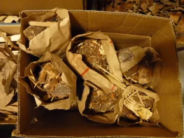

We have a Pacific Energy Alderlea T4.

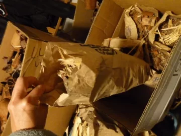

My husband has been fine burnable materials (needles, wood shavings, wood dust, bark bits (birch, inner and outer) in brown paper bags and burning them like logs for a few years now. Never more than one per load, in amongst the log "cabin" of birch that we burn. We also use a top-down burning technique.

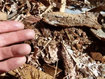

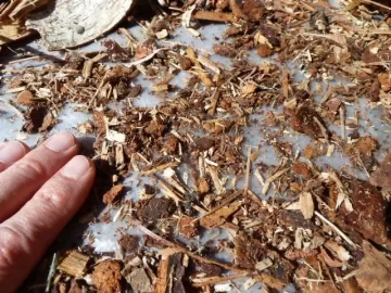

The latest pile of fine materials seems to me (his inestimable wife) to have a lot of material closer to the "dust" end of the scale. It would be about 40-50%, and the rest ranges in size - up to 3-4 inch sized bits of wood and bark.
I am slightly worried about creating an explosion in our stove if we use this new mix of materials in the bags.
In the past, I've filtered out much of this finer material. Now, I'm getting an argument... I mean discussion. :)
I would appreciate comments about the use of the bags in general, and, the safety of this fine material.

I think this a valid question. Way back in high school wood shop, one guy in the class would scrape some of the fines from the dust collector bag and throw them in the air so the 'cloud' was directed at a propane torch...usually resulting in a big WOOOSH! and a fireball. So sawdust fines can do the same thing.
The key is, you need to have 'really fine' fines...flour consistency...even normal saw dust seems to be too coarse for this, and then need to be puffed up in the air in a large cloud.
With that said, I've been burning all manner of bark, twigs, chips, etc for a dozen years or more and no issues with the dust. It's been my observation a lot of the 'really fine' material (at least in my mix) is actually dirt - which doesn't burn / explode, etc. Most anything wood is actually of saw dust consistence or larger, which doesn't explode, either.
