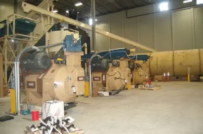

The guy who owns New England Wood Pellet told me that you can make pellets with a wood splitter--it's just that it would take the entire force of the average wood splitter to make one pellet.
Here's what he's using. Those are 500 hp motors on each of those three pellet presses, driving the hydraulics. The heat and force cause the lignin to melt, creating a shell that holds the pellets together. You need dry material for it to work.
