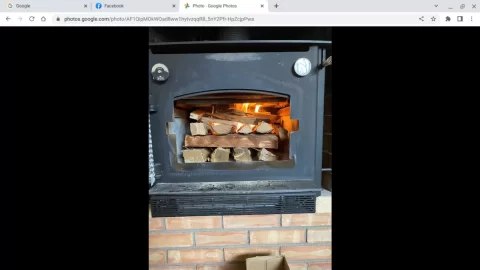

Cold starts I fill er up and light at the top and close the door shortly after. Been doing this for years now. Of course having dry wood is key. I use a half of a fire stick (from Menards)
